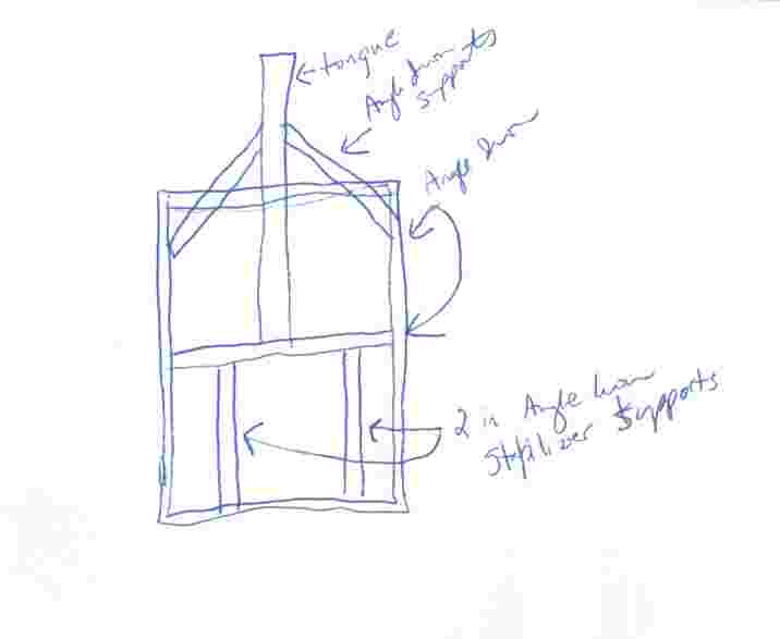

I've had a bit of luck. One of my co-workers has offered to weld me a frame for my teardrop. We decided to do so on Sunday since we're both off. I've been trying to learn the google cad program, but I'm having problems drawing my design on it. I plan on building the generic benroy but in a 5x10 version to help accomodate my bunk system for the kids. I plan on putting the ac, propane tank and battery in a tongue box and I've even thinking of putting one of those cheapo electric safes from HF in there as well for security, so I guess it's gonna need a beefy tongue
It's funny I can find oodles of info on the bolt together frames, but now that I can have it welded I cannot find much technical info. Could be me though, I'm probably looking in the wrong places.
If anyone can offer any suggestions on configuration of the trailer or point me to a thread that deals specifically with welded trailers I'd be most grateful.
I was basically gonna lay out a 5x10 box of angle iron and weld one or two crosspieces to this. For the tongue I was gonna put a thick tow bar(don't know what it'll be of until I see my choices when I go shopping Thurs), then weld two supports in a v to help support the tongue box. I was also gonna put rear stabilizers on it so we're gonna have to weld in tabs. I can look at other trailers and get a basic idea how to do these things, but if I could find a known configuration that would suit my needs I'd rather go with it. I don't want to create a dangerous situation with my inexperience.
Both of our vehicles are v6's, but with gas prices I may get a 4 cylinder next so while weight is not of ultimate concern, I'd rather not build more than I need.
