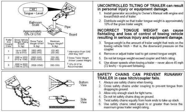

Postby sdtripper2 » Sat Sep 23, 2006 7:23 pm
Ron Dickey:
Here is some information that may help you to choose what size safety
chain you want to get for your trailer.
Trailer Safety Chains
are to be used on trailers based on the GROSS TRAILER WEIGHT (GTW).
So if your trailers GTW is 2K LBS, you should have two chains on your
trailer that cross under the hitch and attach to the hitch bracket.
*Use safety chains rated equal to or greater than twice the maximum GTW rating.
Most likely using the trailer chain charts from below the chain size could be
= 3/16" x 48" chain with two 3/8" S-hooks as a minimum for a 2K LBS trailer
using two lengths of chain and hooks.
Note: (Two chains and size of chain are based on California standards.) My trailer has 2 larger diameter safety chains on it.
