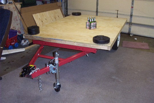

I got a 4 x 8 trailer from Homebase years ago. It had 8" Tires.It look like a HF. I got a HF Mini Trailer with 12"tires the other day as a donor trailer. I used the tires and spring from the mini . I want to build a 6 x 10. I plan to go a foot out on each side. My question is the floor frame. I notice some are 1x2 ,2x2, 2x4s and 2x4 on edge. I want to build light and stout enough for the weight.

First things first. I would venture to say they the springs on that mini trailer are lighter than the ones on the 4x8. Just because there are more leaves doesn't mean they are necessarily heavier.
As for the floor, what I would do since you are going 6 wide is lay a couple 2x2's across the frame except the front and back I would bolt 2x4's on edge to the front and back of the trailer giving a little extra support to the outside edges for wall support.
Of course there are lots of ways you could do it and I'm sure you'll hear more. My only real concern is the width of the axle, seems like it is gonna be pretty far in under the trailer.

My camper is 5 1/2 feet wide on a 4' trailer. I used 2 X 3s on edge for the frame with 1/2" ply over the top. Once it is all together it is very strong. I can't see 3" more on each side making much of a difference. It's not like you are walking on the far edges of the floor standing up or anything. Time will tell Im guess but it seems awfully strong to me. Seems to tow just fine also.

I extended mine on the front and back. My overhang is about 12" on each end. The wide overhang should work well the way you have it.

Don't be afraid to use a couple 2x4s for strength

I found the owner manual on my 4 X 8 and the Max load is 990 lbs and gvwr = 1180 lbs. The mini max load is 1350 lbs.
