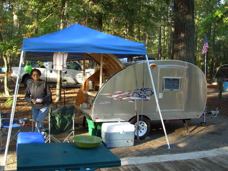

Us too Mike. Here we were set up at MJ's LCG in Oct - Those jacks are great!
