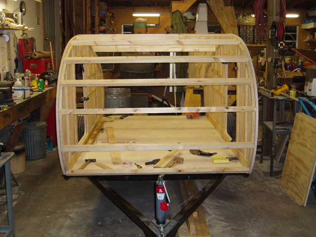

Esteban wrote:Steve T.
I looked at the http://www.saf.com website and found
60" x 120" .4 alum. sheets at https://walden.saf.com/safcustomerweb/orderorigin/OOFrame.aspx?Action=BeginSheetQuote
I recently read that the FishInn is 63' wide. How did you make 60" alum. cover 63" of width.
Do you have a handy alum. stretcher?
Esteban aka Steve B.
edit: I just called SAF and talked to John. 5' x 12' is not a stock item. He told me it would cost a $ 700 upcharge---ouch, ouch, ouch!
At that price Filon begins to look reasonabe.
Esteban wrote:SteveT, Thank you for the information on the thickness of alum. sheet you ordered from SAF.com to get lengths longer than 10 ft. and how you "stretched" a 5 ft. sheet to cover a 5 ft. 3 in. wide TD with 2 in. edge tirm on each side.
I made a trial alum. sheet order from SAF.com:
1 sheet of 0.063 x 60" x 144" ($2.78/sq. ft.) $166.80 (front and roof).
1 sheet of 0.040 x 60" x 120" ($1.76/sq. ft.) $88.00 (hatch).
2 sheets of 0.040 x 48" x 120" ($1.76/sq. ft.) $140.80 (sides).
The total cost today from SAF.com would be $395.60 to skin a 5 ft. x 10 ft. TD with alum. sheet. I didn't figure trim pieces into the estimate. This is over a 100 lb. order, so shipping would be free.
I'm also considering using Filon for some, or all, of my TD's skin. It costs $3/sq. ft. from RV Surplus http://www.rvsurplussalvage.com/catalog/display.php?product_id=1879
Thanks for your generous help,
Steve B. aka Esteban
vipercairo wrote:Steve...
Just me again. Finally started the tear; and am also thinking it may be cost effective to cover with aluminum. Your's is 63" wide... mine is 65 ½" wide... and exactly 12' X 1" nose to tail... but I also see SAF extrusion that is 3" X 1" and even bigger. My question is: did you have to anneal the extrusion or was it fairly bendable without making wrinkles?
#2. Where did you get your porch light? (I like it)
#3. Was the aluminum siding difficult to deal with, i.e. thin enough to cut and finish without specialized tools. I don't know if the .063 is thin enough to work with easily... What adhesive did you use to attach it?
