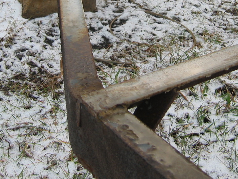

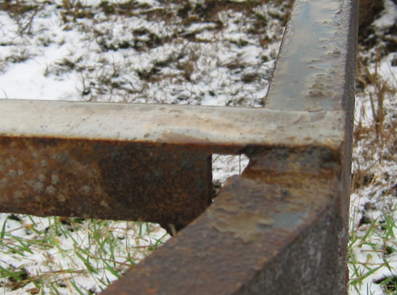

I found a scrapped trailer frame & axels. I need suggestions on how I can make this a sound frame. I know that I am going to re-inforce the bend in the front. I am also going to put a larger piece of steel in the back
Does anyone know how I can rid of all the rust? I have heard of a product that I can paint on to eliminate rust. On the cross beams, they are tacked on the top of the outside square beams. You can see these pictures in my gallery. I am also thinking about overhanging my deck about 1 or 2 inches out on both sides to get my 5' width. I really would like to make this trailer work. It was the right price. I'm having a hard time downloading pictures from my gallery and I've watche how others have been told to do it and I still can't geti ti to work. It's time for a cocktail. Help!

Thanks guys for all the info. I'm trying not to put out too much money. I know that sandblasting is the best. If you look at my gallery photos, the weld joints from my cross beams are welded on top of the side pieces. Can I stilll put a deck on this frame the way it is? I really don't want to re-build the whole thing. I know that I will have to put some more supports and fix any of the cracks that might appear after sandblasting. Will this hinder how solid my attachment is to my deck? I was thinking of routing out a slight groove to compensate for the difference in elevation.

Postby angib » Sun Jan 21, 2007 11:39 am
Dean,
For an economical way of removing the rust, a cup wire brush in a cheap angle grinder will get down to mostly bare metal - though it might take two wire brushes and most of a day to do it. Eye and breathing protection is a must.
There are a couple of surprising details on your frame - the way the main rail has been cut out to fit the cross piece in 'Frame Weld 2' is a bit scary, but if it's lasted this long, it's probably OK.
Rather than rout out where the cross members go, why not find some ply that same thickness as the flanges of the cross members and cut strips to pack the main rails up, flush with the cross members?
