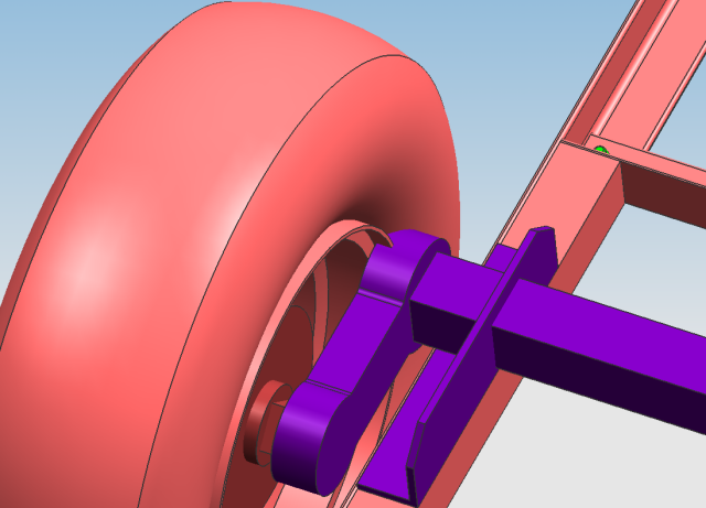

Postby mikeschn » Fri Feb 09, 2007 7:57 pm
Near as I can tell, if you want to use an automotive wheel that has a different offset than 0, you'd have to move your frame rails out, and get the wider axle to match the frame wheels.
And while this might work with a red trailer axle, with a traditional torsion axle, you'd bury the wheel and rim into the torsion arm...
