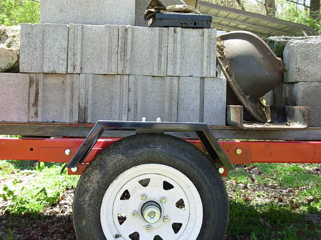

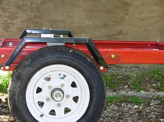

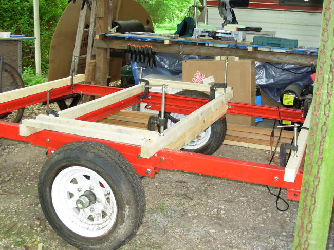

Dunno about the 1175 but my HF 1800# (1740) had less than 1" of the tires protrude above the unladen frame. I made my floor frame of 1 1/2"X2" ripped from 2X6's, extended out over the tires. To allow clearance for spring/load flex I ended up with a very small 'wheel well' inside the cabin; only 1" high & about 6X24". I 'skirted' the floor frame with 1X6 (for looks) & cut out the 'arc' for wheel access. Before doing all this I checked the spring flex by loading more'n 1200lbs of concrete blocks & steel on the trailer frame & measuring deflection (almost nil). I then allowed a couple of inches between the tire top & wheel well bottom for flex over bumps, etc. I ended up with a little less than 2" but I've pulled it over some pretty rough terrain with no appreciable flex & no contact between the tires & trailer body. You may need to allow more clearance for a 1175# trailer?? Here's a couple of pix of the flex test along with floor frame detail. More pix in my album -

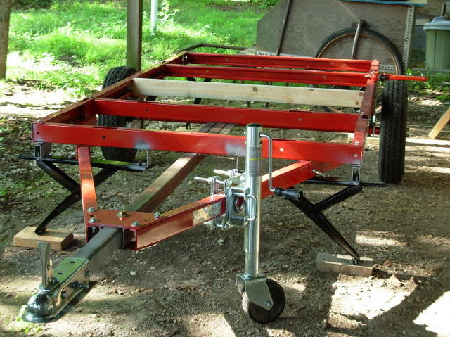

teardropsleeper - I added the additional tongue piece mainly because I couldn't abide the looks of the HF factory coupler mount. You'll notice in the pic that the factory mount is simply a trapezoid plate with a 2.5X2.5" piece welded on that the coupler bolts on. Looked like hell to me, besides with my profile the floor extends about 7" in front of the steel frame & the front wall curve another 4-5" so actually the original coupler mount would have been too close to the trailer body. I simply unbolted the factory plate, turned it upside down (after some judicious grinding to make it fit ;) ) & bolted it to the original A-frame tongue. I then took a length of 2X2X3/16" square tubing, cut to proper length, bolted a pair of 1.5X1.5" pieces of angle iron to the two front cross members of the trailer frame, placed the new tongue piece thru the old factory mount & between the angles, & bolted everything up, after squaring the tongue to the axle hubs. My new tongue puts the front of the coupler exactly 45" away from the nearest part of the curved front of the trailer body. Here's pix of the original mount, & the new tongue installed -
