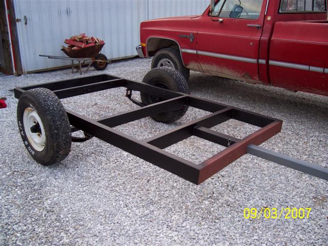

Postby Kens » Mon Jul 09, 2007 8:48 pm
Under $300 welded Tractor Supply.
