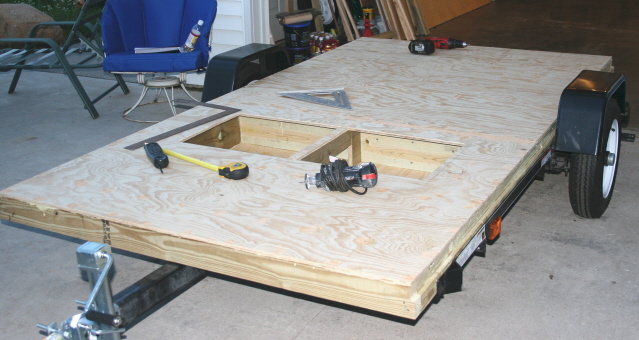

There appears to be quite a bit of space between the 12 inch wheel and the frame.
bet the 15's would fit with zero offset, of course the fenders have to come off.
thanks for photo little critter.

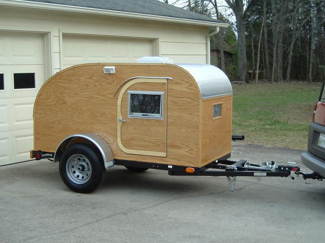

I've got the same NT 5x8 trailer, and the way I measured two weeks ago, the 14 inch wheels/tires on my teardrop (shown below) will not fit the NT trailer.
From wheel mounting flange to tire sidewall is 6 inches. On the NT trailer, the flange to trailer frame distance is only 5 inches. My 14's are standard trailer wheels, so I dunno.
FWIW, the teardrop is a 4x8 HF frame with torsion axle.
The RoadCamper the old teardrop
Scooter
