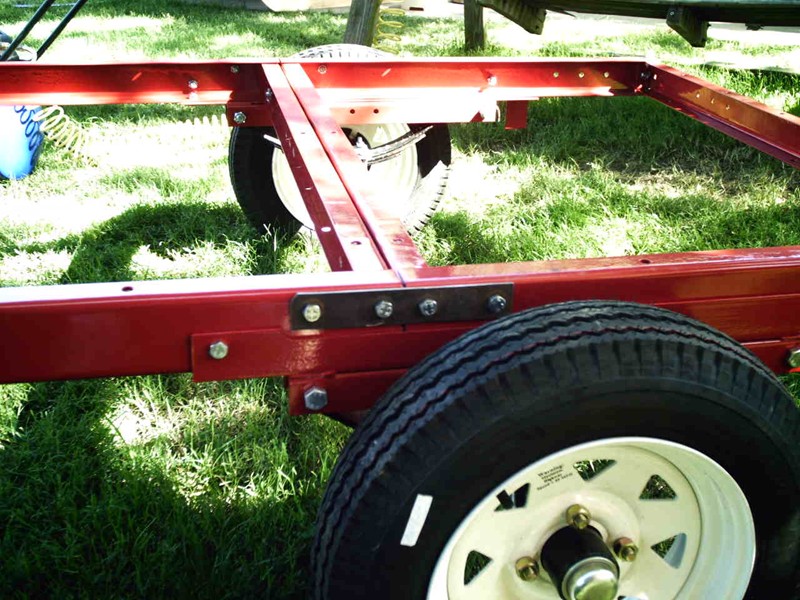

Postby T-TownTear » Sat Aug 11, 2007 12:36 pm
I cut a 1/8 steel strap to go on the outside of the frame just for a little more strength.

Postby Alphacarina » Sat Aug 11, 2007 3:28 pm
Having a welder run a quick bead over the joint would be a very good idea too

Postby Dee Bee » Sat Aug 11, 2007 6:11 pm
I put the cross pieces inside the side rails to make the folding trailer frame a rigid frame.

Postby apratt » Mon Aug 13, 2007 9:19 am
Dee Bee wrote:I put the cross pieces inside the side rails to make the folding trailer frame a rigid frame.
Frame Assembly page http://www.nfdc.net/home/cbdb/Teardrop%20Trailer.htm
Dee Bee
Looks like you could even make the trailer longer real easy doing it that way. Good idea and would be very strong. :thumbsup:

Postby steve wolverton » Mon Aug 13, 2007 7:14 pm
Damn. I should have done that.
Maybe I will this weekend and make a larger dropped floor. :thinking:
