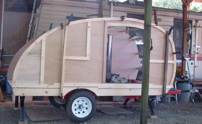

Don't see why it wouldn't work but, it ain't necessary either. My TD is 60"x114" (5X9.5') built on the HF 1800# (think all the dimensions are identical to the 1740). I modified the tongue as I couldn't abide the way the HF coupler looked, & I needed a little more length because most of my 'overhang' is in front ('sides, the longer tongue makes backing up much easier). Think I have about 12" in front & maybe 6" in rear (this includes the curve of the profile). My floor frame is 1.5x2" actual dimensions, ripped from 2x6 spruce, tied together with 1x6 white pine side rails & 1/2" plywood floor. This thing is solid, & when bolted to the trailer frame with ten 7/16" carriage bolts, there is absolutely no flex in the overhang, sides or ends. Here's a couple of pix with lots more in my album -
