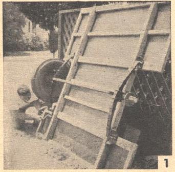

If you look at the Lightweight in the Vintage Plans menu item above, you'll see that has 2x4 wood chassis rails with half-laps, although it does also have some important diagonal braces from the coupler to the front of the trailer body.
Personally I hate half-laps as they just introduce notches that act as stress-raisers to crack the timber - I would always prefer to see longitudinal and transverse parts passing over/under each other or, in the case of most cross-members, simple butt joints used.
