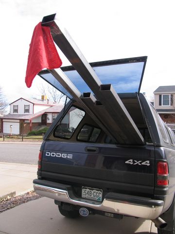

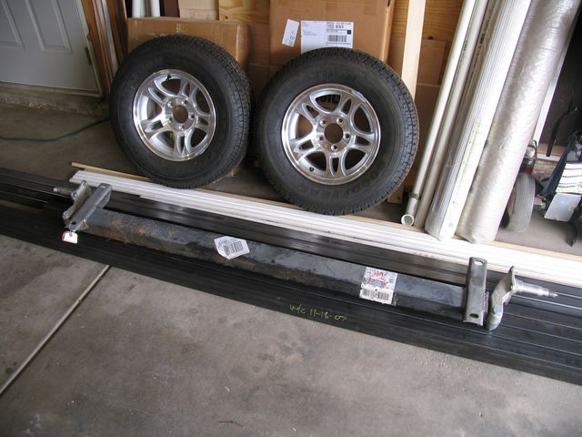

I picked up my steel today. They were out of the 2x3x1/8 for the tongue so I'll have to go back for that.
I've got the wheels and flexiride axle ready to go.
And so it begins....

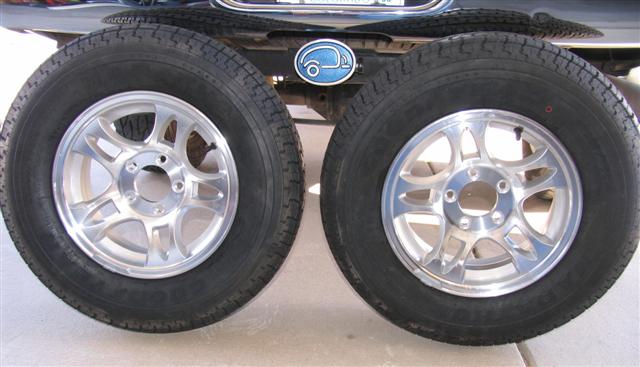

P.S. Here's a closer view of the wheels. They sure are shiney!
P.P.S. The hitch cover is from Cherokee George...
