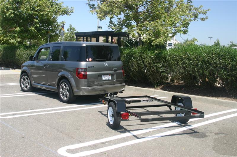

I built my trailer on a Tractor Supply 4x 8 frame. Now that I'm nearly finished do you think its too late to get some additional bracing welded on to support the tongue? Can they do this with the trailer cabin already built?

i don't see why it would be a problem. just use some splater paper or we rags near the arc and hot metal if you get too close to the wood and foam. should work.

Doug, this tough...if you have any burnable materials in contact with the frame in the area of the welds it WILL burn...all you can do is weld a little at a time and thenput the fire out quickly...of course then you just might cause a weak weld...you could probably weld the braces on the tongue and then bolt them to the frame........

Looking at your trailer... I don't think it would be too hard to weld a couple angled tube braces from the tongue back to the second crossmember? ...and where they would cross the front crossmember too. Since they would be down below the main frame, I don't see any problem other than the fun of getting to the welds from underneith the rig. I guess you could just tilt the whole thing back and go for it? A mig rig shouldn't get things too hot... But I would sure keep the water hose handy! :lol:
Jack's idea of bolting the part under the tear may be the best (as in safer) way to go...
