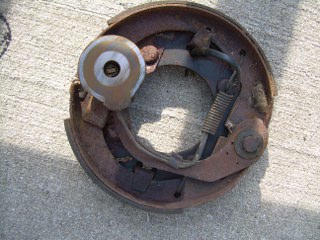

Postby tbeau » Mon Mar 24, 2008 8:25 pm
After taking apart the wheel, I think my decion was made. I must replace. So where should I start. Where is the best and cheapest place to get brakes?

After blowing up picture and looking at it, I don't see much of a problem, yes magnet has scrape marks, but that is normal, shoes look like they have plenty of lining.... Unless lining is separating from shoe they should be good... What is see is a bit of time with a wire wheel and a bit of paint....
