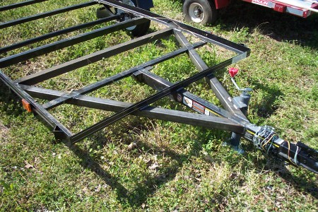

I didn't think the Northern Tool 5 x 8 trailer tongue was all that strong. So I had a few things added. Now I need to paint it and put on the floor.
Before
After
Added another cross member. Welded the tongue to the first and second cross member. And welded a jack to the tongue.

...good looking upgrade Bob...I have come to believe, that most all of the inexpensive trailers available, with only a single tube tongue need a similar upgrade...too many of them have/are failing at the same point(the first crossmember)........

Looks great :thumbsup: and a wise addition. I understand single bar tongues make the trailer shimmy while being towed. :) Danny

You all are absolutely correct. This is a very poor design. When I purchased this trailer I could see something needed to be done to strengthen the tongue. But it was hard to pass up the sale price. And the axle was already moved back and lowered.

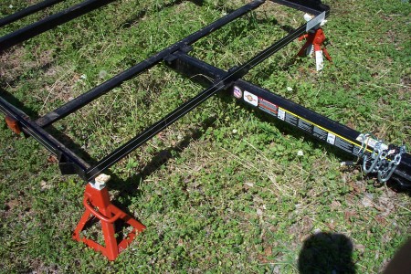

The tongue doesn't go back far enough into the trailer frame. I put a jack stand under the two front corners and by pushing down on the end of the tongue I could flex the second cross member up and down. Put several hundred pounds of weight on the trailer and it's real easy to bow that second cross member.
So to anyone buying this type of trailer, be prepared to do something with the tongue.

Yep, there is an apparent design flaw in the NT and TSC(and maybe others), single tube tongue on their lightweight, no-floor trailers and they need to be beefed up in the manner that Bob has done...to that effect, I am going to make this thread a "sticky"...thank you Bob, for showing your excellent fix for this apparent problem............

In case anyone reading this wants to copy Bob's mods, I would comment that it's the two new diagonals connecting the tongue to the side rails that are really giving the benefit. Adding the extra cross member does nothing for the vertical strength of the tongue and I don't believe it's necessary. Ain't doin' no harm, though.

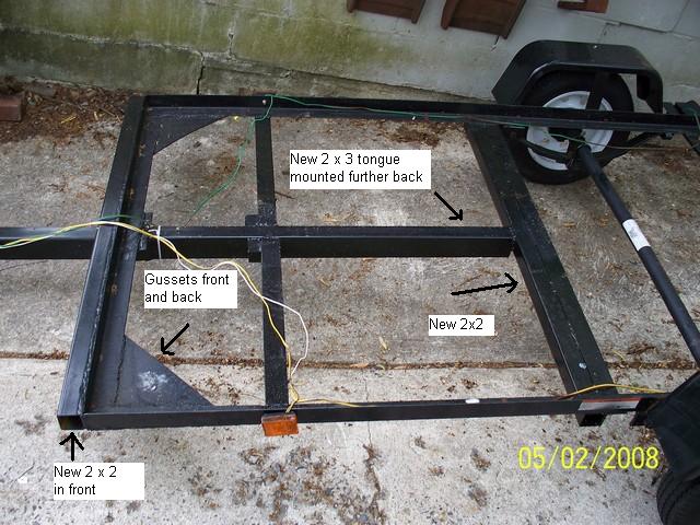

This is what I did with my TS trailer, I can stand on the trailer with it connected to my hitch and it no longer flexes and im no light weight. I bought a new length of 2x3 long enough to extend almost to the axle and add almost a foot up front for a tongue box. I will be adding the diagonal
sections soon, thought I already had the material at home, but I was wrong :NC

On my trailer the angle iron is only 1/8" thick. I think having the diagonals helps spread out the up and down forces on that front cross member. And they also help square up the frame.

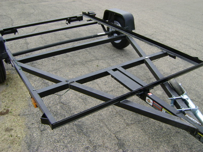

I realize this is a very old thread, but it's a sticky, so I thought I'd post a pic of what the guys at Perham Steel did to reinforce the tongue of my 5x8 Northern Tool no-floor trailer.
They moved the wires for the trailer lights down out of the way of the 2x2 1/8" thick steel square tubes that they attached to the third cross brace. Pics of that in my album.
They were able to keep the bolted on wheel jack by sawing off the bottom front bolt.
Still trying to find a way to mount the 5# LP gas tank plus a Lowes SUV storage box to the tongue. The wheel jack needs to move closer to the hitch in order for that to happen.
I also took it in again so they could weld a rear hitch receiver to carry a bike rack...or whatever.
BTW my trailer bed is not square...off by <1/4" on front driver side corner. Take a tape measure when you go to buy your trailer. You'll probably end up painting the whole thing, so don't be worried about the finish or a few rust spots. Just go for the most square one.
