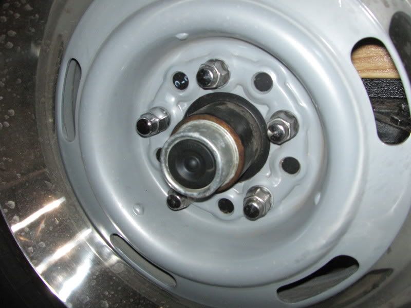

I bought a Flexride torsion axle from Southwest wheel. I want to grease the bearings. I sent them an email since there was nothing on their site about maintainence. They say use a high temperature wheel bearing grease and pack them seasonaly. With that being all they say, am I supposed to pull off the wheel and take the hub assembly apart and hand pack the bearings? Or do I just use the grease fitting that is already there? Which way is better and what grease do you recommend?

Personaly, I find most hubs come improperly lubed from the factory. Plus, you never know what grease they used. I like to clean it all out, and pack it properly with the type of grease I plan to use. Some people like the black moly grease, others the sticky red colored stuff. Either will work as long as it is rated for wheel bearing use. Is the grease zerk in the center of the axle? If so, it is probaly like the Dexter EZ lube setup where the grease is pumped in from between the inner seal and bearing, and pushes everything outward. I would repack the bearing by hand (you will probaly need to buy a new inner seal to get the inner bearing out) then pump the grease through untill its full and coming out.

Mike, The zerk is just under the rubber cap on the hub. So do you never use the zerk, or you hand pack the first time and refresh with the zerk once a season?

Yup, that looks like the EZ lube style. Once I know the grade of grease, I would have no problem just pumping more in periodicaly to keep the lubrication up. The problem is some greases cant mix with other greases, and if you try and mix them, they seperate and destroy the bearings. I would pack by hand, then pump untill it flowed out the first time. As for yearly maintance, yes, just using the zerk will repack the grease, but you should also inspect the bearings and check the nut for proper adjustment as well. If I had relativly few miles on a trailer a year, I would have no qualms doing the inspection every other year of so. If I'm really putting on the miles, I would grease through the zerk every 5 or so thousand miles and inspect/adjust yearly.
