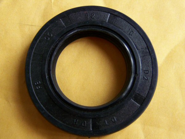

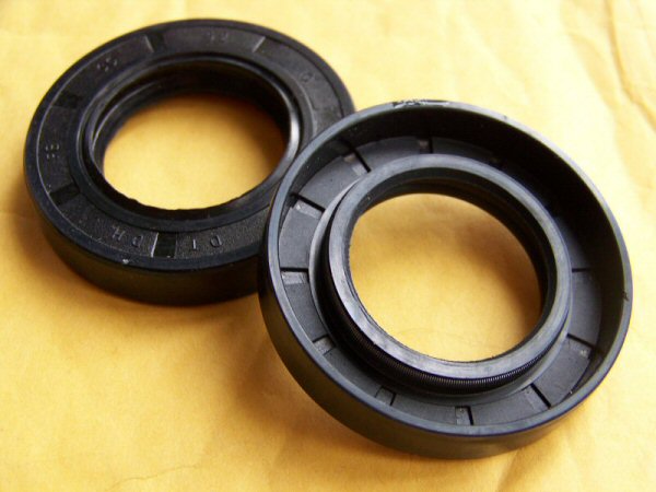

These are the seals they sent:
They are made out of hard rubber/plastic with a pliable ring of rubber in the center ring that goes around the axle shaft. Can you actually use this on a hub? Can one really trust it wouldn't deform with heat? These are nothing like the seals I have. The seals I removed are metal with a soft rubber ring.
The other thing - the seal numbers don't match. My seals were labeled 31-52-7. These rubber things are labeled 30-52-10. Can I use a 30-52-10? (The axle measured 31.4 mm OD. Hub 52.2 mm ID. Hub depth - 8mm.) Fortunately, I was really carefully in taking the hub apart so I was able to put the old seals back in, but now I'm wondering how to find the right seals? And not hard plastic things! I'm hoping that with the repacking I'll have a few thousand miles to go before repacking. But what if a seal fails in that time?????

Please tell me you have not thrown away the original seal. Go to the yellow pages and find a BEARING house. They handle industrial as well as automotive bearings and seals. They are available you just need to know where to look. Are you sure your wobble is not a tire problem I have just been there (see Harbor freight tire warranty thread). The plys let go in the tire. They need #60 of air pressure bet you arn't there.

If the seals are removed by dragging it out with the rear bearing there is usually little damage to it and it should be reuseable . There is no need to replace them each time. Inspect the inside wiper ring. (The soft rubber area that wipes the spindle). If there are no cuts or tears and the seal will still set flat. You can reuse it without worry.

Take the seal to a bearing place. I think (operative word here) the seals are 7mm wide.
Bearings and seals are standard just about world wide. You should have no problem finding them.. I bought new bearings and seals for my h/f 1800# trailer about 5 miles from me, just as a precaution.. never used them yet.
My h/f bearings had a standard timken number on them. The trailer was made in Ukraine.

kiacker wrote:They are made out of hard rubber/plastic with a pliable ring of rubber in the center ring that goes around the axle shaft. Can you actually use this on a hub? Can one really trust it wouldn't deform with heat?
What heat?? I don't know if you are just commenting or not, but there is no "heat" on a properly installed trailer hub.
