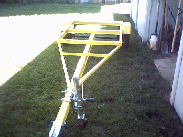

I also used that frame, with a tongue extension. I do like your A bracing idea better than mine. But I think you should make the center go all the way back to the second cross member. I had problems with the original tongue and harbor freight extension, namely it would twist when I put weight on the jack(put the jack at a 45 degree angle). Here are the results and my frame with modifications.
My thoughts are replace the tongue with a longer piece of square tubing (http://www.angib.pwp.blueyonder.co.uk/teardrop/tear84.htm for strength reference)(if you have trouble understanding this engineering chart, someone will help, they did for me), also where the tongue is joined to the cross members is where the weight is transfered from the tongue to the frame, so by attaching to two cross members this joint is much stronger.
Summery use your A frame idea, and replace the center piece of the tongue with a longer piece of square tubing, being attached to two cross members.
my 2c del
