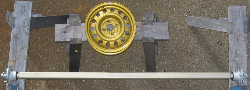

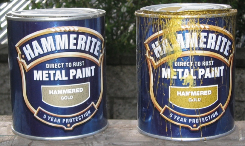

Believe it or not. My axle & rim are the same colour.
At least according to the labels on the Hammerite tins.
The paint on the rim was bought around 2 years ago. The axle paint was bought 2 weeks ago. Other than the obvious colour "change", the only other difference is that the later version can be rolled.

Wow that a big change. I love Hammerite paint. Some of the best paint on the planet.

Did you stir it up real good? Gold paint settles out and really needs a good stirring. Could be a change toward a more environmentally freindly formula also. I like the rim color better, its brighter and more bold.
Maybe you can call Hammerite and send them a pic and see what they say.

I did stir both of them according to the instructions. Which didn't make any obvious differences to their colour.
I actually quite like both colours.
The brighter one has more rust "hiding" qualities. Whilst the more recent version is more subtle & quiet.
I've just asked Hammerite about the differences. And will let you know what say.

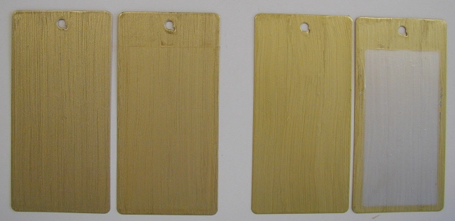

I've just received a reply from Hammerite.
"They have confirmed that the colour of hammerite gold changed significantly when they reformulated to a new pigment (Solar Gold). This new formulation gives better UV resistance then the old formulation.
The panels below show the UV resistance. The first 2 panels show new formulation before and after accelerated UV testing. Similar for the 2 panels to the right but using old formulation.
Whilst this shows some colour difference (new vs old) the difference in colour change is much more significant in Hammer Gold - the old formulation being a very strong yellow colour.
