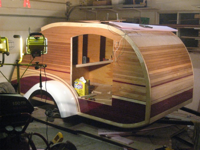

Ya know...this Tear thing gets to you. After awhile...everywhere you go you see stuff and say "Gee..I could use that on the next build!"
Sad part for me is that No. 1 still ain't finished...and it's been a couple years now!!!!
Hey..it was kinda like this in college...took 6 years for a 4 year degree..but in the school of T&TTT, I feel I have graduated basic trailer, profile and cabinet with a C+ average...now I'm taking Hatch 101!!!

Juneaudave wrote:Ya know...this Tear thing gets to you. After awhile...everywhere you go you see stuff and say "Gee..I could use that on the next build!"
:oops: :oops: :oops: :roll:
This trailer looks like well beyond masters work, A+ would be selling it short.
