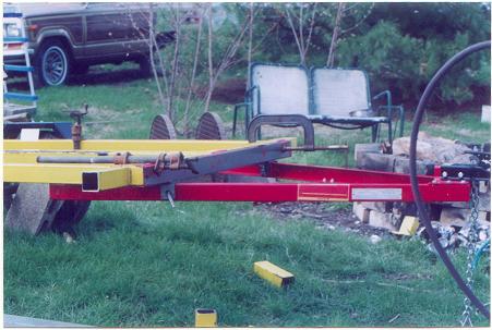

Thanks for the photos - more Q's
Postby bobbruso » Mon Jul 28, 2008 11:26 am
Thanks for your fast response on those photos.
From the looks of the top photo, the coupler looks the same, but it is bolted to a red plate with a channel piece welded on? I guess the Red piece is what is missing.
I have a bottom flat plate (unpainted) but nothing to go on the top of the 'A'.

Postby Endo » Mon Jul 28, 2008 4:03 pm
bobbruso wrote:Thanks for your fast response on those photos.
The part you are missing is the coupler base. Call HF they may still send you a new one????
Brad (aka Endo)

Postby toypusher » Mon Jul 28, 2008 4:26 pm
It is part # 6 in this pic - you may also need part 5
