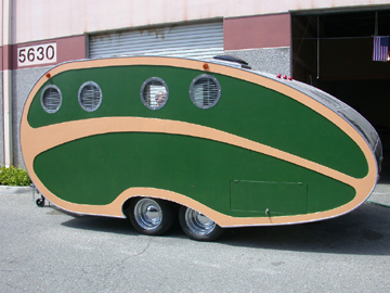

The pic is off of www.maxitear or just type in maxitear. He has a build diary that is pretty thorough. A bit ambitious for a first build though.
have you decided if the 7x12 will be a standie or simply a larger teardrop
my tear is 5'7" by 9' 6" so you are very close to that! I could us 2 more feet in length for a real nice tongue box.
