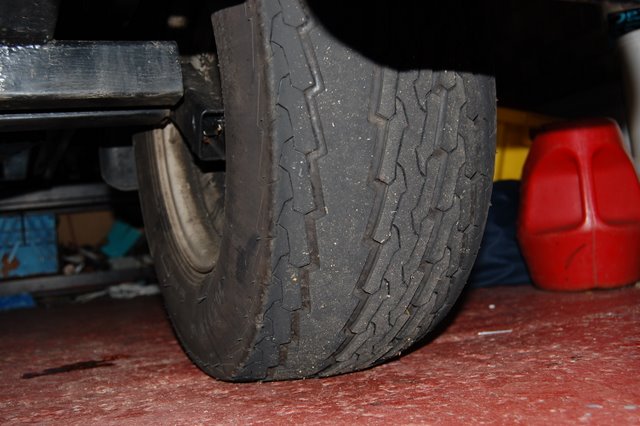

I have a problem with scrubbing tyres
As you can see the inside tread is wearing much faster than the outside.
I have measured the angles.
I get a [edited] camber] (bottom of wheel outward) of 2 degrees.
6.5mm further out at the bottom of the steel rim.
And [edited] toe-out] (twisted about the vertical axis) of 0.5 degrees.
I am baffled. The [edited] camber] is not very much, 2 Degrees, common in many motor cars and would not its self result in scrubbing.
The [edited] toe-out] would scuff but its only 0.5 degrees.
I can correct the [edited] camber], by adding a hardwood wedge between the suspension unit and the frame, but not the [edited] toe-out].
For now I intend to swap the tyres over and get my money's worth but I need to solve this for the next set not to wear out so quick.

I think you have toe confused with camber. toe is how much the tires point in toward the frame. Camber is how much the tires lean.
Measure the distance between the front of the tires and the rear of the tires to detwermine the toe angle. I am willing to bet you have a substantial bit of negative toe (tires point out from the frame at the front) that is causing the excessive wear pattern. To adjust it you may need to reposition your axle mounts or may need to replace them if they are loose and causing the tire to twist slightly while being towed.

I've never liked stubs for the reason of the problems you are having... Can you get a straight edge (or line) between the 2 stubs to see if they are mounted correctly.....
Even with 6 bolts, the stubs can/will move.
If you find they are not in alignment with each other, can you run a piece of angle iron across between them to line them up (and leave it there permanently)..
also, are they mounted to wood (poor design) or metal?

I used a laser and projected the parallness (toe out if you like) of the wheels onto my garage door 5 metres away. This calculated to an angle of 0.5 degrees for each wheel.
As I said (forgiving terms) not enough I think to cause scrubbing.

What you describe as your Camber @ 2 deg and toe-out of .5 deg will both cause the tire wear you are experiencing. Try to adjust your camber to as close to zero as possible (+- 0.5 deg)
Set you toe to about 1/32" toe-in

2 degrees negative camber (top of tyre leaning in) seems fairly small to cause what looks like pretty severe tyre wear - though photos can be misleading.
However any negative camber on a trailer isn't good for stability. Something like 1-2 degrees positive camber (top of tyre leaning out) gives the best towing behaviour - it's all to do with 'camber thrust', but I'll not discuss that further in mixed company....
Fixing the camber would be pretty easy - a washer or two under the middle mounting bolt hole and double that number under the outer mounting bolt hole would do it.

...this is what I would do to check things out...
1) on one side, measure from the front of the steel frame to a point around 1"(2.5cm) in from of the axle bracket...
2) take that measurement and transfer it to the other side...
3) measure from the front of the coupler to that mark on both sides...they should be the same...
4) place some sort of straight edge across those two marks and measure back to the axle mounting bracket at either end of both brackets...are those measurements(all 4) the same...
most straight axles are bowed up in the middle to account for weight deflection so that when loaded, you get near neutral camber...don't know how that applies to stubbies.......

I had the same problem on my trailer. The person that owned it before me backed into a stump and bent the axle forward in the middle. Only one of the tires wore like that. The problem is that both wheels are actually toed out in the front and are not running parallel to the tongue. The trailer when towed will not track straight behind the car and will drag one tire more than the other.
Also check you tire pressure. I will bet the one in the picture is lower than the other one.

This camber (in at the bottom) can't be the whole problem. I remember a 1970's small BMW. It's rear wheels stuck out at the bottom an enormous amount.
Thanks rainter
Sorry but this is something I did not include in the post. The wear is exactly the same on the other tyre.
Thanks Madjack
I will do some more measurements this week end. You make an interesting point.
Thanks bian_bp
This is what I was looking for, a written definitive answer.
Thanks angib
The good news is that I can easily alter the camber. I think I favour wooden wedges over washers. I have already selected the bit of teak I will be making the wedges from and with bian_bp help I know how steep to make them. This weekend I will be the swapping the tyre on the rims to get my moneys worth out of the rubber.
I am still left with a doubt however about this BMW with its massive camber and that the wear could be from the toe out, which I can't easily alter.

Your picture shows wear on the inside of the tire - That means the wheel is leaning in at the top and out at the bottom . . . . negative camber
2 degrees of negative camber by itself wouldn't necessarily wear the inside of a tire like you have and neither would half a degree of toe . . . . but if you combine them both, you could see some real problems. No trailer axle should have any built in negative camber, because that will only get worse as you load the axle
I have a pair of stub axles very similar to the ones you pictured (mine are Flexirides) and their mounting plates have about 2 degrees of positive camber built into them because as you load a trailer axle, the camber typically goes more negative, so with mine it would even out at near zero camber when the axle is loaded
If you have negative 2 degrees static, you could have a couple more than that in a loaded configuration and maybe even a couple more in a jounce situation, so your negative 2 degrees might actually be as much as 5 or 6 degrees in some situations. Are your axles mounted right side up (under the frame)? You can't use them reversed or they will have negative camber to begin with

These is the kind of camber story's I was thinking about. I understand that the camber was there to improve cornering etc but it did not lead to high tyre wear.
The wedge I intend should bring it from 2 deg camber (out at the bottom) to 1.5 Degrees (out at the top). see technical date ref from brian-bp.
Hi Alphacarina
He wrote "Are your axles mounted right side up"
They are the right way up. The trailing arm would not load up properly if not. But thinking out of the box is good.
This picture is upside down, right.
