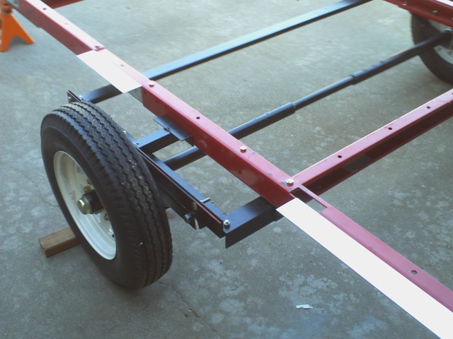

I built an axle frame for my 4x8 hfImage

Postby madjack » Wed Sep 24, 2008 12:10 am
Jim Marshall had the right idea for building 5' wide on a 4' wide trailer and keeping the wheels outside the body....go here and scroll down for pics...clickyclickyclicky
madjack 8)
Posts: 15128
Postby okedoketear » Wed Sep 24, 2008 7:47 am
Wow, that's some nice frame work! That goes along with my thought pattern. I appreciate everyone's input. I will go ahead and build out an axle platform then. I will post photos later. Thanks everyone.
