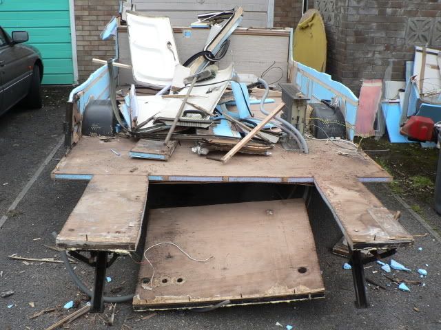

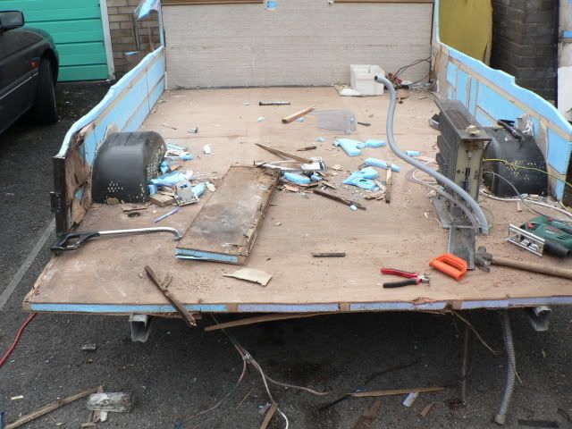

It really depends on how long the chassis is to begin with. I started with an old 2 berth caravan and and ended up cutting the best part of four feet of the back of the chassis and about two foot of the front of the floor panel to give me what I thought would be a good placement for the axle.
I did a rough calculation on the likely weight of the materials to build and fortunately this turned out fine as the nose weight is OK. If it hadn't been I might of had use ballast on the front or rear to get the balance right.

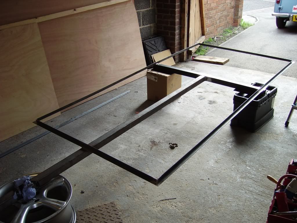

Postby Rigsby » Tue Oct 21, 2008 2:55 pm
Is it definatly an alli chassis or is it galvanised steel? For £50 i would get it any way and weigh the alli panels in and use any bits you can for the build. Personaly i would go for a custom chassis, something like the one i built
or the one i welded up for Northern Munkie

Postby t4camper » Wed Oct 22, 2008 8:20 am
Rigsby wrote:Is it definatly an alli chassis or is it galvanised steel? For £50 i would get it any way and weigh the alli panels in and use any bits you can for the build. Personaly i would go for a custom chassis, something like the one i built
http://tnttt.com/viewtopic.php?t=25491
What would something likes of that cost to get made up then ?? , and would it really be my best option, i suppose from poi nt of view of the fact i would be able to have it made to measure so to speak it might be the best option for this type of build howver buying indespension units for it would not be cheap, although i do like the alloys on it it would be cool if i could get the trailer to accept wheels the same as my vans ones !!!

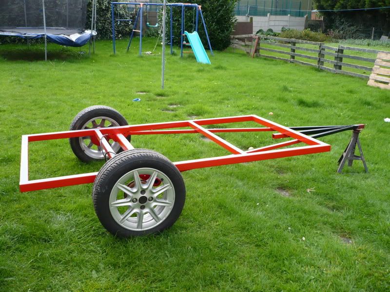

Postby Mini Renegade » Wed Oct 22, 2008 12:53 pm
Dougie, whilst I can weld I wanted a pro to do the job for me. the basic chassis below including a load of left over steel (enough for 1 more chassis ) cost me £85 plus 15 for a ready made cross beam with mounting plates fitted.
I added a couple more crossmembers myself the painted it.
the cost for it all inc suspension units was £200.

Postby Rigsby » Wed Oct 22, 2008 4:33 pm
The most expensive bit of my chassis , was the wheels at £20. All the metal was salvaged from one place or another and the axle came from an old trailer. It might be an idea to look on ebay for a 6x4 or a 8x4 trailer and adapt that as a chassis for the td. I asume that being in the Dub scene you will know a welder that will do a few mods to a chassis for a favour or a beer
