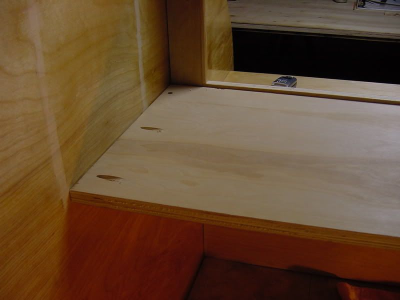

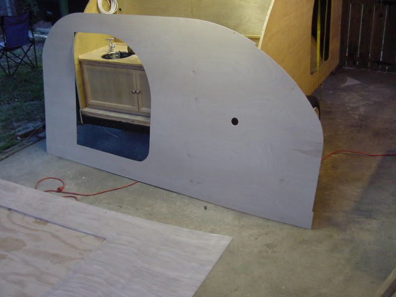

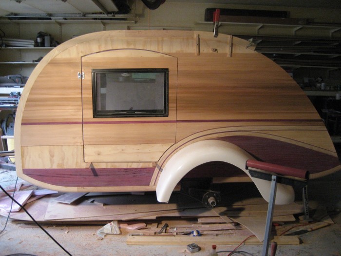

Ken B. wrote: I've seen in pictures many Tears that have finished wood sides with no evidence of covering screw heads on the outside finish. How were the bulkheads and galley cabinetry attached to the walls? Ken
Steve_Cox wrote: countersunk screws with wood plugs.
Use glue and a brad nailer to attach cleats to the insides of your walls - No screws or nails through from the outside needed, so nothing to coverKen B. wrote:I've seen in pictures many Tears that have finished wood sides with no evidence of covering screw heads on the outside finish. How were the bulkheads and galley cabinetry attached to the walls?
