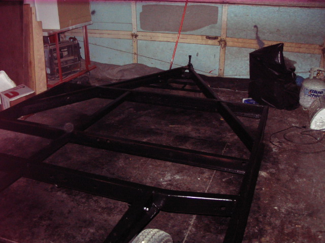

Postby Mark McD » Sat Jan 17, 2009 9:26 am
Got the frame blastedd, primed and painted, in spite of -10 degrees temp!
