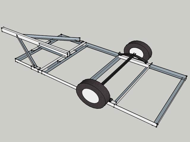

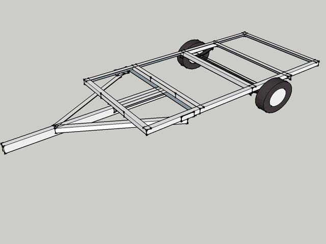

It will be made of 2x2 angle iron, 2x2 square for the axle mounts, and a 2x3 tongue and is 4'x8'. The tongue is 3' 6" long from the front of the first cross member.
Any recommendations on whether i should use 1/16 or 1/8" angle?
Does this design look safe? Any ideas to make it better? My plan is to bolt it together and get it welded later if it needs it.
Again any input is greatly appreciated.
