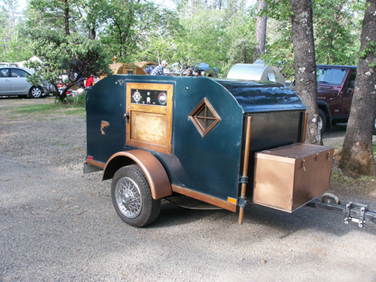

It mostly has to do with having enough room for the fender and a door on such a small trailer. Of course you could build one like this one:

Postby TinKicker » Sat Feb 07, 2009 8:56 pm
Kevin, thanks for that simple answer. Yes, I know proportions are very important. I just didn't really know if it was something learned the hard way, like "back in '92 I built my tear 80/20 and it broke in half on the turnpike at 80 miles an hour" or something.
Yeah, I could see me crawling in and out of that little door. That fender would look like crumpled newspaper from my butt and knees beating it down. Must be some wee little folks going into that one. :lol:
