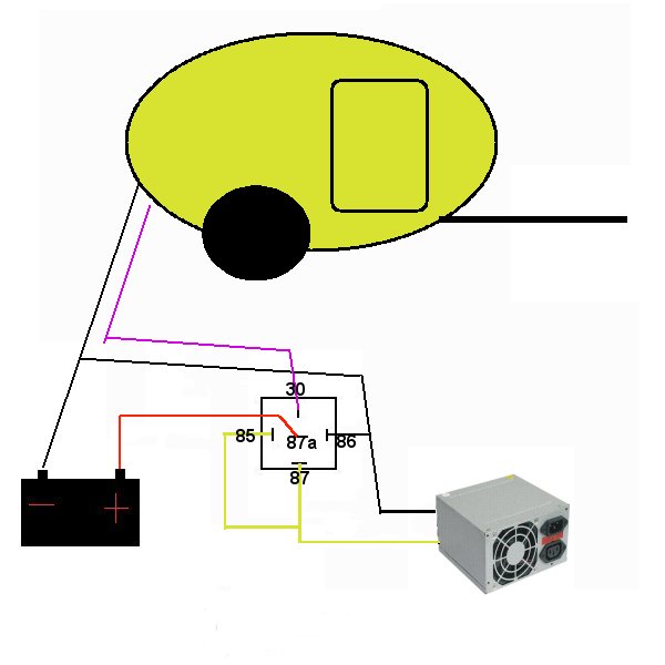

I did quite the reverse of what your talking about. Since my trailer came prewired for 12volt for everything, I planned for it. I have rewired a computer power supply that puts out clean 12.3 volts. I added a marine trolling motor battery and wired in an automotive relay so that when I plug in a power cord, it automatically stops taking power from the battery and the computer power supply starts powering the trailer. When unplugged it drains from the battery. The battery lasts me 5 to 6 days one 1 charge. I've been going to throw a small battery charger into the mix so that everything is 100% automatic when I plug a power cord in it starts charging too.
I have a charge pack and found that my trailer was out of power in 1.5 - 2 days. It might be due to the low quality pack though.
I made this lil graphic to explain this in another thread awhile back so here's another chance for it to shine. There is no charger in the diagram but its just connected to the battery and hardwired into the 110 coming into the trailer.:)

Postby bbarry » Sun Feb 22, 2009 9:10 am
Wimperdink wrote:I did quite the reverse of what your talking about. Since my trailer came prewired for 12volt for everything, I planned for it. I have rewired a computer power supply that puts out clean 12.3 volts.
Interesting!
From what little I know, most computer power supplies put out current in a variety of voltages, including 12v, 5v and 3.3v. Did you just isolate the 12v supply and wire that into your circuit?

Postby Wimperdink » Sun Feb 22, 2009 8:49 pm
bbarry wrote:
Interesting!
Brad
They do put out those voltages yes... The wires are color coded. The yellows on mine put out 12v, the reds put out 5v and I forget the color of the 3.3v.
I cut them all off close to the board except the yellows as I don't need the other voltages.
firemaniac wrote:Wimperdink, how long has the power supply system been installed? How is it holding up to the power demands? And any complaint's or should have done's?
:thinking: I don't anticipate using AC power often, but when I am plugged in such a system would be perfect for light's and tunes.
I've had it in there for at least 6 months now and it stays plugged in. Mine had a switch on it so I can turn it off at will which I havent done. There's a constant blue glow from the display on the stereo but I don't leave the lights on.
As for the only thing different, is that I still need to add a charger. I'm looking closely at the chargers made for boats that are onboard chargers that stay connected to the battery always. They come in a small lightweight package that just stays connected. I have yet to install the electrical pass through, but I will use a marine plug in for that and hardwire the charger and power supply direct to the 110 pass through. Doing what the drawing shows, will do three things at once when you plug into 110. Remove 12v draw from the battery, Turn on the charger, and turn on the power supply that will now supply your 12 volt. When you unplug the cord you get the opposite. unplugging will shut off the charger and the power supply and redirect draw from the battery again.
As for it holding up, I have cranked up the radio, turned on all 4 lights and turned on my vent fan. The lights dimmed slightly when I hit the fan but nothing to be concerned about. Using all LED's would help lighten the load significantly.

Postby tinksdad » Sun Feb 22, 2009 9:30 pm
Wimperdink wrote:I did quite the reverse of what your talking about. Since my trailer came prewired for 12volt for everything, I planned for it. I have rewired a computer power supply that puts out clean 12.3 volts. I added a marine trolling motor battery and wired in an automotive relay so that when I plug in a power cord, it automatically stops taking power from the battery and the computer power supply starts powering the trailer. When unplugged it drains from the battery. The battery lasts me 5 to 6 days one 1 charge. I've been going to throw a small battery charger into the mix so that everything is 100% automatic when I plug a power cord in it starts charging too.
I forgot to mention I have two normal 12v lights inside and one outside of each door, and I'm running this exact stereo. (walmarts cheapest) It has an aux jack for plugging in my ipod, and it also has a usb charge jack built into the stereo. Cant be beat for charging phones, ipods, nintendo ds, etc etc.
I like the idea of using a computer power supply to supplement the 12V side of the equation.
Correct me if I'm wrong. I know the old XT power supplies were connected direct to the power switch on the case so that when the switch was flipped the power supply turned on and sent power to the motherboard. The newer AT/ATX mother boards are wired to the case switch, so I am assuming somehere in the 20/24 wire connector from the power supply to the mother board there are a couple of wires that would have to be jumped/crossed/connected to fool the power supply into thinking there was a motherboard attached.

Postby bg » Sun Feb 22, 2009 9:56 pm
tinksdad wrote:I like the idea of using a computer power supply to supplement the 12V side of the equation.
AT power supplies still used a master switch
ATX power supplies have a pin on the motherboard connector that must be connected to ground.
Basically you jumper out the "ps_on" (pin #14, typically a green wire) wire to ground. Test an ATX power Supply

Postby Wimperdink » Sun Feb 22, 2009 10:14 pm
bg wrote:AT power supplies still used a master switch
BG has it right. And I stole the idea from Jamesm. :) There was a thread in the electrical section on this board with a conversation about how to convert it. Mine is an atx supply with a power switch built in and yes I put my green wire to ground. You can do a search here for power supply conversion... or google has a great deal of info with pictures on how to do it.
or click to see this thread....
http://www.tnttt.com/viewtopic.php?t=22592&highlight=convert+power+supply
