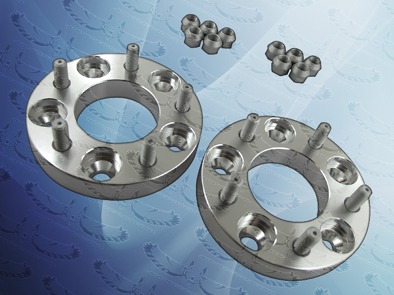

If you need spacers an inch or thicker, you can buy a set like these, which come with their own studs to mount the wheel
I've used a set of 1.5 inch thick spacers like these on my 1500 pound motorcycle trailer which I built from an HF 1740 kit for many miles with no ill effects on the bearings. Bought them on eBay
Another advantage to these type spacers is that you can buy them to fit your trailer hub and also to fit a different wheel which otherwise wouldn't fit on your trailer hub, so you can use them to 'adapt' to many different wheels
