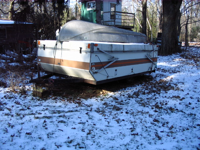

Postby Mark McD » Fri Feb 27, 2009 7:32 pm
Both of my previous pop-ups had 12" built past the front of the frame (over). Also out the back. So my current frame is 10'0 long, the pop-up that was on it was 12'0. The ends are also cut back on an angle. Check out the pic:
