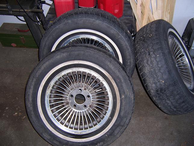

Postby Tom7707 » Mon Jun 29, 2009 3:01 pm
Thanks for the ideas on my axle. I think I am just going to build a few inches wide. Another reason for that is that I found a set of Ford Rims (and tires) for $100.00 here in town. I really only wanted the rims but for now I can use the tires to work on the trailer and get new ones later.
I will need to clean them up a little but I was looking at spending a lot more on them if I were to buy retail. Being a cost effective (cheap) type of person I think these will work fine for what I have in mind. After I finish building I will purchase new trailer rated tires for the rims. Now, if I can only get the wife to start polishing them!
Later guys

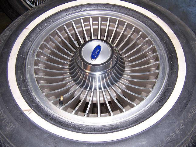

Postby Tom7707 » Mon Jun 29, 2009 3:05 pm
Here is a picture of one rim starting to clean up. Lots of work to go.
At this rate I may be able to start my trailer frame this week or at least get the metal to the house.
