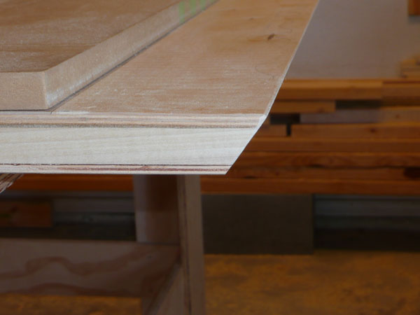

Postby aggie79 » Wed Sep 23, 2009 4:56 pm
I used 1/4" plywood (actually slightly thinner 6mm Russian Birch), 3/4" framing (1x2s laid flat @ 16" o.c.) with insulation in the voids, and 1/4" plywood. Here's a picture of it (ignore the 3/4" mdf straight edge I used to make the bevel cut with my circular saw.)
