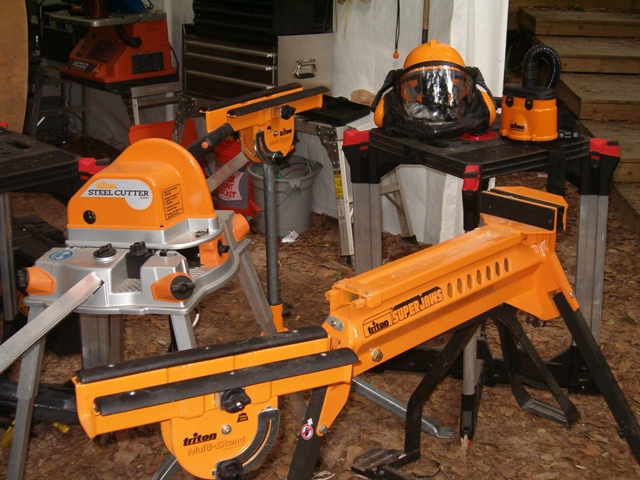

I usually use the Triton Steel Cutter for miters in material 2" and under with good results. It is much like a chop saw but uses a carbide tooth blade, is set up for 90 or 45 degree cuts and has more safety features than you can imagine. It is shown in this picture of my "Triton tool collection", it is the one that says "Triton Steel Cutter" on the side. :lol:
Though this saw makes rather accurate 45 degree cuts, I agree that extreme accuracy in the cut is unnecessary as allowing a little gap between the two pieces in a weld promotes better penetration and a stronger weld. Proper setup and welding procedure can result in square frame with less than perfect cuts. :thumbsup:

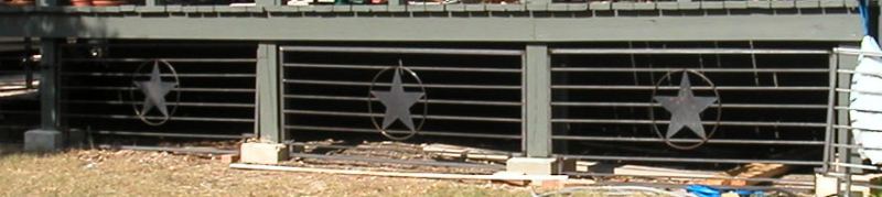

I used that Triton saw to make all the miter cuts on close to a dozen of these panels. Due to the notch required on each end of the bottom, each panel had 8 mitered corners (that's sixteen 45 degree cuts per panel). I guess I never got around to taking a picture of this project after the panels were painted and properly installed. They are just propped into place in the pic, after I actually installed them they are all plumb and square with each other. It was a fun project I did for my wife's mom. She had originally requested that I fill those spaces with wooden lattice panels, she decided she liked my design better... :thumbsup:
