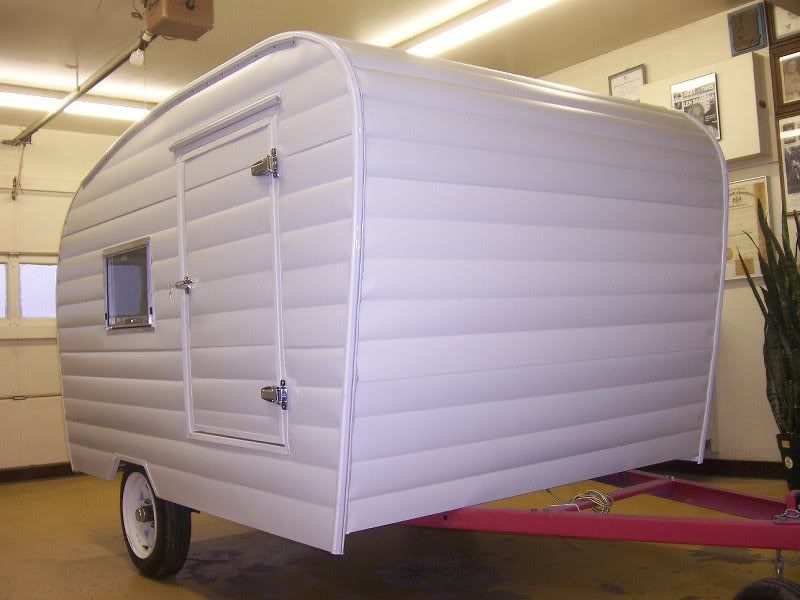

Postby len19070 » Tue Oct 27, 2009 4:56 am
I wrote this siding tutorial a few years back and Bev was nice enough to organize it For me.
I like to post it just before "Building season" for all the new projects
http://www.freewebs.com/kc8jwa/Lensidingfinal.pdf
It gets a little sticky at the "Joining pieces of siding end for end" part.
But for building a tear from step #31 on does not really apply.
Its very easy, its just like folding paper.
BTW there's a suggestion in there that you "Make a Brake". Do yourself a favor, spend the $40 a day and rent one (@HD)
