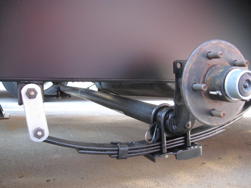

In an ideal world we could build the trailer then weigh the axle and purchase an appropriate set of springs to closely match the load on the springs...not to practical for most folk. But I recently de-rated the factory springs on my cargo trailer somewhat according to Rob's excellent post. I eliminated the short bottom leaf and trimmed the middle leaf in the photo 3/4" at each end. No point in having 3500# springs on a trailer that will have maybe 1700# on the axle. That's a bit overkill. If this mod doesn't work out well when the trailer is finished my fall back position is to buy some 2000# springs from Northern Tool rather than operate with "reasonable guess" rated springs. I just hated to pitch out the heavier springs...seemed like a waste.
