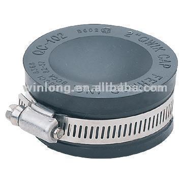

As a thought go to local hardware or building supply and rummage round in PVC/ABS section to find a Rubber Cap that is held on to pipe with a stainless steel worm type hose clamp.... Its not perfect, and I don't know how durable (lasting) it is but I have seen them used to protect hub/bearings when the regular "steel cap" was not to be found.... Measure hub outside diameter first..
