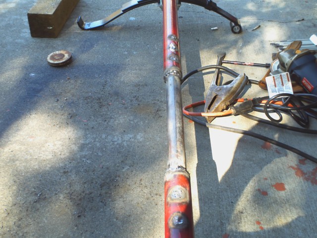

Postby FlyerSkip » Thu Apr 22, 2010 9:47 am
Very nice. The last axel I stretched all I did was clamp it in some angle iron and weld it down. the angle keeps it straight as you go. Not very pretty though.
