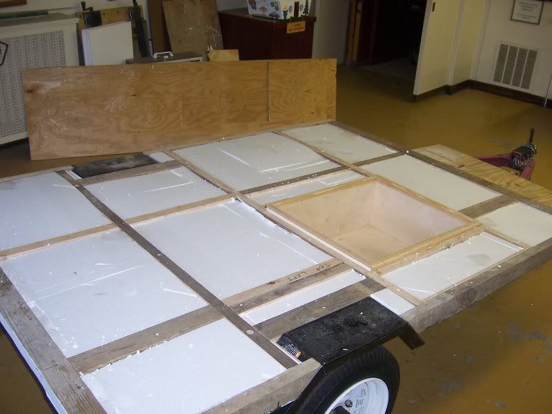

I have a good 4' wide frame with torsion axle and want to build a 5 wide. Got my plates today and have 30 days to take it to inspection. In the meantime, I will be taking it to a welder to have the axle moved back. Just wondering if I need to add some extensions to the sides or if building the floor out over the frame is OK. If I do build out past the frame, should I use hardwood beams for extra strength?
Pic of underside. Old floor will be removed after inspection. The floor shown is 8' long by 4' wide and you can see that it goes over where the frame narrows to meet the tongue. My main concern is how far a 5 wide will stick out away from the frame at the front corners.

I built a 2X structure and mounted it on top of the 4' section of frame and sheathed it with 1/2" plywood.
This meant that the overhang was sitting on something stable and I had no fear of it dipping.
By raising the the deck it also allowed me to make a flat floor w/no wheel wells popping up into the cabin area.

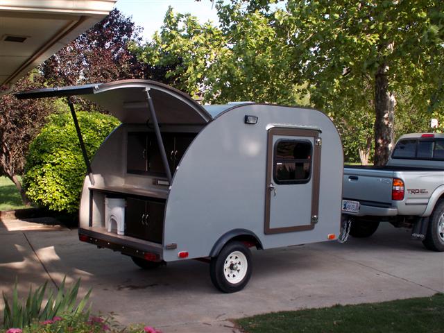

Here's my 5 wide x 9 long on a 4x8 HF frame. Lots of build pics are in my album.

Cliff, Perhaps I don't understand your question, but maybe this pic will help. I ended up with wheel wells in the cabin but once I made up the mattress with 5 inch thick foam and notched it around and over the wheel wells, you don't even know they are there when laying down (or even see them for that matter). The walls drop down over the side by about 3 or 4 inches to hide/cover the frame. PM if you need more info or if I missed the point of your question.

You did answer it!! You dropped your side walls down 3-4 inches so you lost 3-4 inches out of your inside height in the TD. Thats what I was trying to figure out.

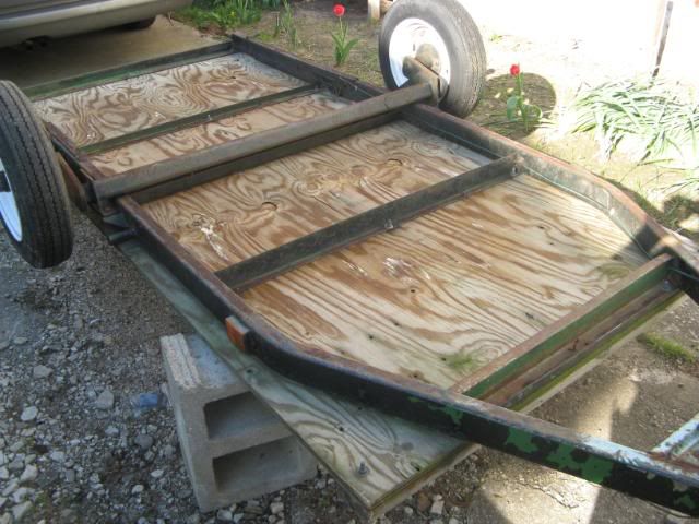

Wound up 5' 7" out to out side to side
Later removed fenders and built up floor with 2 layers of 3/4 blue foam and a sub floor of 7/16 osb to eliminate wheel bumps.
other frame picks in the album pg 39 - 40

Postby bobhenry » Sun Apr 25, 2010 11:26 am
FYI In the picture above there was not enough room to change the tire. It turned into a nightmare. Thank God I found out at home.
Here is a much later ( 2 years ) pic of the same trailer note the tiny wheel wells.
Lesson to be learned , try changing the tire to check for clearance

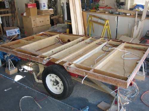

I went up 4 inches so as not to have bumps in my floor for wheel clearance. Makes for a high trailer.
Look close and you'll see some allthread run crosswise near the wheel well. I got to worrying about having the box cantilevered over the wheel there and decided it would be best to keep the floor framing under compression.
