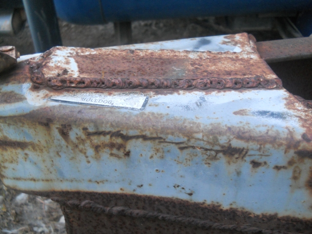

No dh, no real problem that I can see. It is just that it is a homemade trailer and is only 3'x8' and made of really heavy "C" channel. I guess that I feel like if I am going to be adding to it to make it wider I would be useing lighter material and dont really know the quality of the original workmanship (welds look a little if'y). I guess my real question is more about the axel. Do y'all think it will work? Does it sound to be about the right size for a six ft wide, ten foot long trailer?

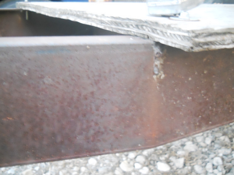

My biggest concern is always the tongue. Is it a single tube, a "Vee" tube, or best of all a "vee" with a center tube? How far does the tongue extend under the trailer?
You can cantaliever the sides out and no it won't tip over :roll:
Best of all the price is right :D
Like someone said pics please!
I have seen 1st hand the aftermath of "Roadside repaired" tongues and I decided to beef up the HF tongue the 2x2 center section extends to the centerline of the axle. So even if the tongue is a bit "Iffy" you can modify it.

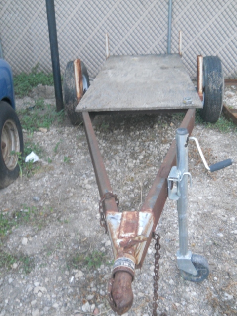

http://tnttt.com/album_ ... c_id=70070
The trailer itself.
http://tnttt.com/album_ ... c_id=70069
The welds I was talking about.

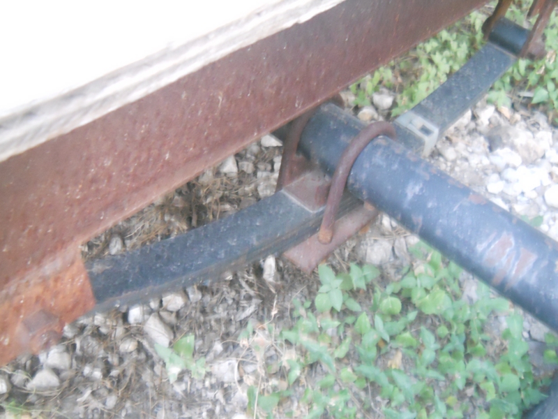

http://tnttt.com/album_ ... c_id=70068
The springs look pretty good.
http://tnttt.com/album_ ... c_id=70066
The tongue construction, it is notched and bent. Made out of 2"x5" "C"

Postby Woodbutcher » Tue Aug 24, 2010 7:38 pm
That trailer looks like way overkill. Plus you are going to have to rework or replace the axle to get a 6 ft wide trailer on it. Looks like way to much rework. I would do like someone else said. Try and trade or sell this one and put the money into what you really need.
