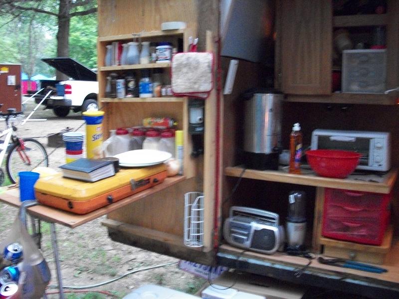

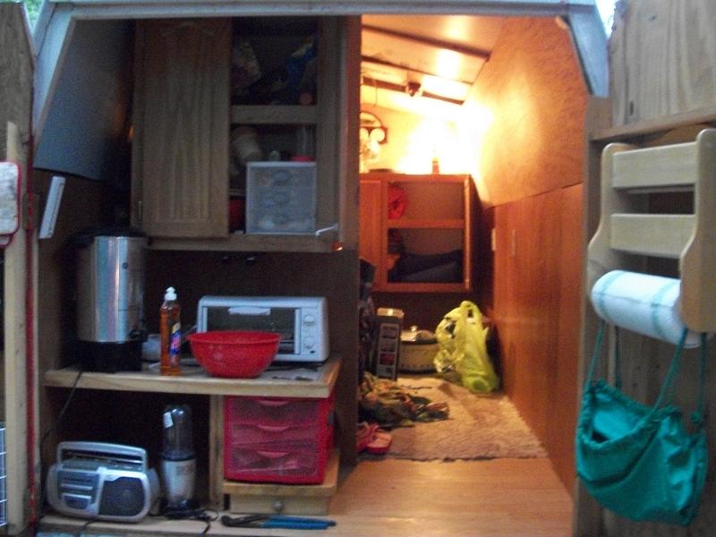

The barn box is 5'4" wide ( plus about 5" of fender on each side)
by 10'0" long by 5'6" inside at center peak. I can't fully stand up
straight but I can get my pants on while standing inside. You might
concider a non standard build to get what you want.
Here are a few shots of "Barn to be wild"
You will notice in a couple of the side shots the fenders are
only partially extended outboard. Ther is about 2 1/2" of the
fender encased in the sidewall. It will give you the wheels out
look without adding quite as much width.
We really need a caboose build on the forum :lol: :lol: :lol:
