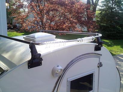

This customer wanted a roof rack for both a changing room and to carry a kayak. It is a 4x8 Kit clone, and the rack is Yakima. I think the side towers are "Rain Gutter" towers. With a few turns of the side knobs the towers unscrew and the bars can be removed. It just leaves a small similated "rain gutter" bracket, , fastened to the 3/4" plywood walls with SS fasteners

prohandyman wrote:It just leaves a small similated "rain gutter" bracket, , fastened to the 3/4" plywood walls with SS fasteners
My "twopennyworth" (actually around three cents...) is that for the 99% of teardrops that don't have slowcowboy's bullet-proof roof construction, this is the strong way to attach roof racks.
It seems worth mentioning this as some folks seem to think that it is stronger to attach to the roof but it isn't - any load in the roof has to get into the walls anyway (what holds up the roof?) so it's better to put the load straight there. Spreading out the point load in the walls would be nice - either by using a big attachment point or by adding a big backer inside the wall.

Prohandyman, I like that rig you showed. Had intentions of transitioning through the roof, but I could easily use a bracket like you used on the side instead. Looks strong. Would probably be more watertite, too. I'd just have to add an exterior support in the front (weak end of camper).
