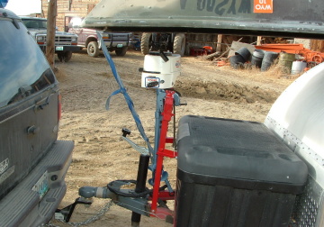

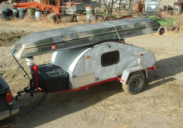

Postby zelix » Thu Apr 21, 2011 1:20 pm
slowcowboy wrote:12 inch and they were 30 bucks in 2009 at napa. well worth the dough.
I did brace the tongue but not a lot. just had dad weld on a A frame bull dog hitch that did alot for the tonuge than I had him weld on two light angles off a bunk bed for the tongue box and that did most the bracing on my harbor freight trailer.
heres a good close up of my teardrops tongue and bull dog hitch and tongue box.
little white and blue thing on the red mount on the tongue of my teardrop in front of my tongue box is a 2 horse power neptune 1978 boat motor.
its for the jon boat on top the teardrop that is straped down.
the boat motor mount really does nothing for tongue bracing and has only been on my teardrop for a month.
heres what your looking at the hole rig.
and heres the acutal teardrop and the tow vehicle.
I have had a lot of fun with my motifed harbor freight trailer off road in the wind river moutains and I really like my monroe 12 inch gas shocks.
Slowcowboy.
