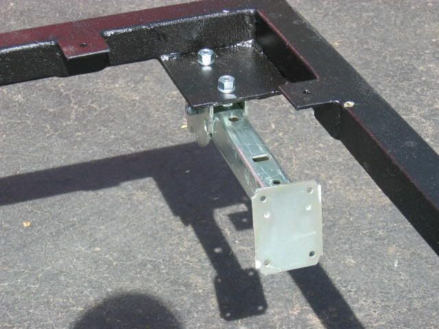

You need stabilizer jacks. They look like this folded up. Some people just use the tongue jack and form a tripod with the tires.

System like above is ideal... There is several different types of bolt on supports the can be used...
Another solution is maybe a couple of scissor style auto jacks from auto salvage yard or "jack stands" from auto parts store...
(these are similar to ones pictured by Woodbutcher))
IF you camp on fairly lever places a set of wood blocks will work....
A simple system to setup is to disconnect trailer from tow vehicle, lower tongue till it is below the level line of trailer, place any stands or blocks or jacks under rear corners of trailer then use tongue jack to bring trailer up to level... A small level placed on tongue will tell you when its level.... The idea is to get the stands to take some of the weight off the trailer suspension and that will reduce bounciness of trailer due to the springs still trying to work when there is any "motion" inside trailer...
This link will give you a idea of what options for "jacks" or "stands" that are available to stabilize trailers...
http://www.easternmarine.com/RV-Trailer ... abilizers/
Another good link would be to go to GOOGLE search, select "Images" and enter in search box "trailer jack stands" or "trailer stabilizers"....

Postby DMcCam » Wed May 25, 2011 9:47 am
I've got a similar set up to Woodbutcher. These were recommended by several other builders so we decided to use them too.

Postby Mightydog » Wed Jun 01, 2011 4:50 pm
We have the same set up as Woodbutcher.
We lift up the trailer with a scissor jack and then lower the stabilizer jacks to make everything level. It's a tripod with the tongue jack providing the third point of contact.
