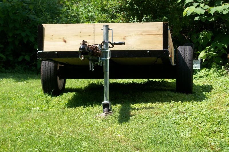

Acquired an I-Beam welded axle trailer. No springs. Couple of car spindle / hubs attached to the end of the center cross mounted 8-in I-Beam on a 4 x 8 trailer.
What is the down side of no springs? Is it safe?

I have a car trailer that has no suspension and without a load it will bounce the pickup lick crazy, and it gets very annoying, with a load I can sometimes feel the weight shift on bumps to the hitch on the pickup. On a teardrop I would think it may bounce the TD apart.

And every little rock and pothole will shake up (or apart) everyting inside trailer.....

Thought that might be the case. Heavy vibration and all. The last owner of this utility trailer said to just run the tires soft. Thanks for the sanity check.

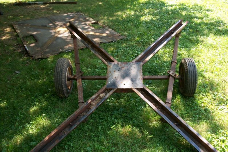

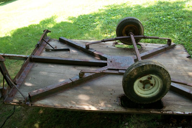

I do have the remains of an old Apache Camper. If I could sub my axle on it's frame.....
Image[/img]

It's not relevant to your situation, but those are really interesting photos of that Apache pop-up chassis - it just shows how much can be left off a small trailer frame if you have the experience to do it.
The out-of-straight springs and axle U-bolts put on diagonally are a bit of a shock to the eyes, but I guess they worked. The tongue is not really attached to be main frame except by that one bolt - it really is mostly just attached to the front of the body.

I would use the apache trailer. take the 4 u channels weld 2 together making 2 8ft channels. reattach the axle to that. get some tubing steel and weld 4 cross members in place. weld the tongue back on. total cost of steel would be about 40.00 and you would have your td frame

I would use the appache frame as well. Just look at those nice loooong springs. (or so it appears in the photo) They'll ride much nicer than the more common shorter/stiffer springs.
I can see using the framing as is, if it has a good tongue. Go with the ultralight trailer design, or just rebuild the frame into the typical rectangle as mentioned.
