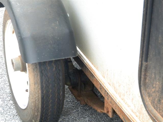

Postby CliffinGA » Sat Oct 08, 2011 6:19 am
Galen on my small tear when I bought it with its 12" tires it had the fenders mounted to the axle. I decided to go with 14" wheels and a bigger fender and when I started taking them off how thick the bvracing was, 1/4" to 3/8" thick. It worked for them on the smaller liter fender for the 12" tire but the bigger fenders for 13" -15" wheels would have to be a lot strong.
Moho check for flea market, thats where I got my whhels w/tires and fenders:
Old
Black objects in front left is fender right is fan shaped steel plate welded to fender and axle
Cliff :thumbsup:
