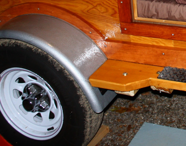

I have fiberglass fenders, but most steel fenders could be mounted the same way. I used stainless steel carriage bolts through the sidewalls to mount the fenders.
First, I made a template out of 3/4" mdf to locate the drill holes in the fenders and in the sidewalls.
After drilling the holes and painting the bolts, I inserted the carriage bolts through the sidewalls.
I don't have any pictures of it, but I used rubber fender welting between the fenders and the sidewalls. The welting is held in place by friction, but to help hold the welting temporarily to the fenders I used weatherstripping adhesive. Then I mounted the fenders using a little loctite on the threads and nylock nuts. The carriage bolts were a little too long, so I cut off the excess length beyond the nuts.
As far as clearance, I have about 3/4" on both sides (measured from the bulge of the sidewall, not the tread) and about 2-1/2" from the top of the tread to the bottom of the fender.

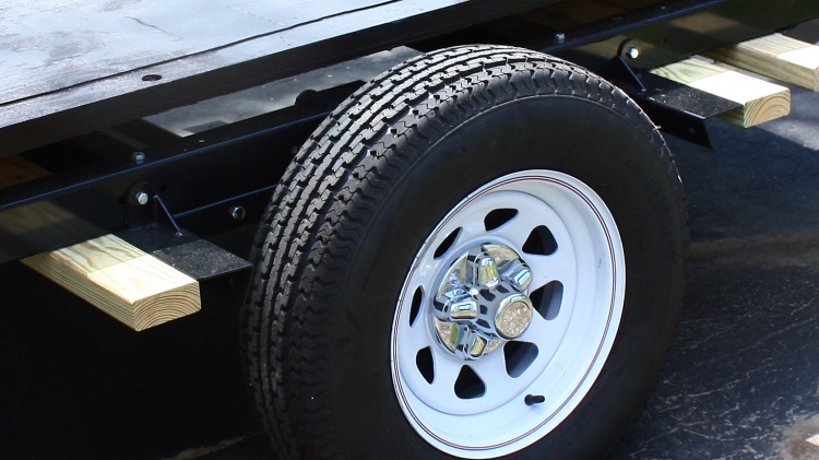

Good point, a picture is worth a few words here:
In the picture the fender is only sitting on a scrap piece of 2"x4". I don't want the tire rubbing on the fender when I hit a large bump. How much travel does the average torsion axle have? Mounting the fender to the axle itself would allow tighter clearance and my 1/4" birch sides wouldn't have to support the weight. Anyone with pics of axle mounting brackets?

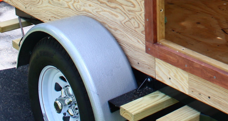

I used a modified steel fender as I wanted it wider. I tried to have the trailer fairly loaded before mounting the fender and left 1 1/2 inches between the tire and fender. We have hit some good bumps and it has never rubbed the tire. I think it looks better with the fender close to the tire IMHO. I just used 3 carriage bolts from the inside with lots of sealer. I see guys using a lot more bolts that that but I am not sure why.
